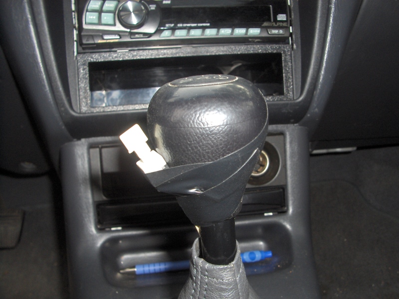

This was the initial install of the kill switch on my Paseo. I later replaced the very low quality switch (which eventually started acting up) with something designed for a few more cycles. I couldn't find pictures of the new one. I will note that the electrical tape didn't hold more than a couple days in the hot summer. The newer switch was held to the shifter shaft via double sided tape and some zip ties through the mounting holes. It works great.
